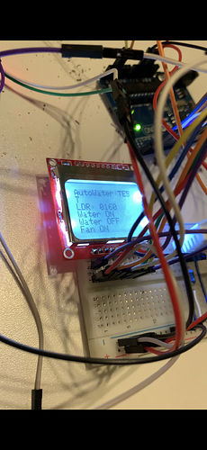

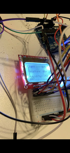

The temperature and humidity of the air only on the serial display are displayed as a percentage, on the lcd as you can see in pictures,no.Can these two appear on lcd in percent?Thank you in advance

The first thing I see from your photos above (a long time ago now - I’m sorry) is that the lines are all one character too long. I’ll fix that first.

I think it should have displayed the air temperature in addition to what is already seen on the nokia lcd
Whilst looking at the formatting of the values (lines too long for the display) I noticed that I’m not formatting float values for humidity and temperature correctly. So I started looking into that and which function I should use, then decided to trial that code on an Arduino by writing it to the serial communication. This led to a search of my electronics boxes and ending up not finding my Arduino Nano so hours of fun - NOT. Sorry about the delay because after that I had a lot of other chores around the house I had to do. I’m still doing them today but wanted to let you know why I’ve not replied. I’m going to order another nano now (or a few of them) and then I’ve got to get back to my chores.
