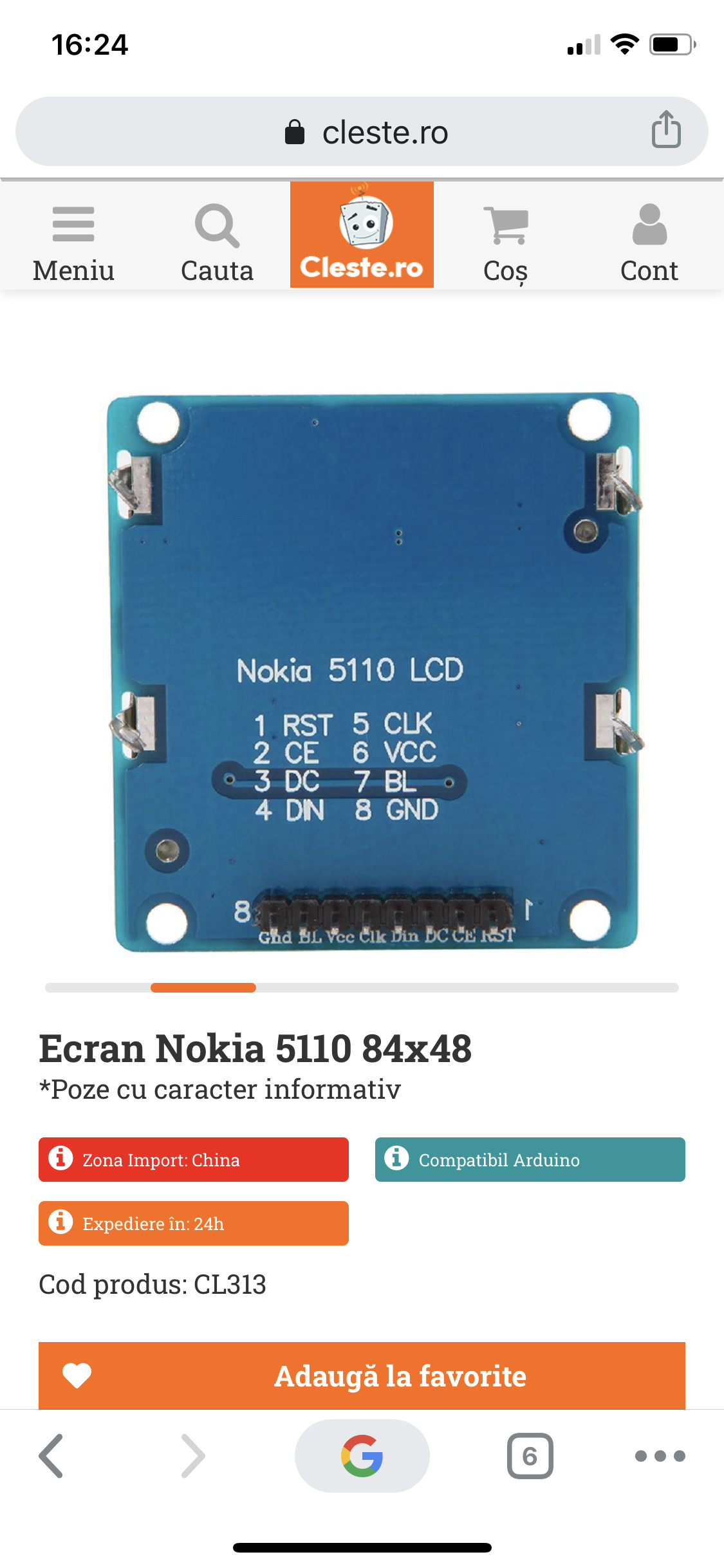

This is the lcd i have.If it s not good, i will buy another,but i don t know what kind,i thought this nokia lcd is the one in the video. :slight_smile: Talk to you when you will be back and you will have time :slight_smile: I wish you again a great weekend :blush:
Oh! I’m so sorry, I misunderstood and reworked the code for a 20x4 version of the same LCD. When I’m home tomorrow I’ll change the circuit and the code. Sorry but I don’t have my computer with me today.

I still have a little problem, after you noticed in the pictures with my lcd, the pins are named differently than the lcd pins in the circuit
And they are in another order. Order would not be the problem, but I do not know what pin on my lcd is the dc pin and cs pin :frowning: i think i guessed the rest of them.But please look at the picture with my lcd and if you know,please tell me know which pines correspond to those of the lcd in the circuito.
I’m sorry,I’m not good at this :frowning:
